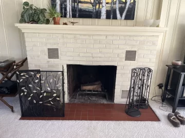

We have an old fireplace that we had inspected recently. To use as-is, we will need to reline the chimney and properly seal it. The inspector also said we could put in a wood insert as an alternative, which isn't that much more expensive. We would love to have a wood insert, but the issue we are having is that we have these vents (I believe Heatilator vents). There is no blower or electrical at the top. The bottom ones are too close to the opening for a wood insert to fit without interfering with them.
Considering that we are going to switch to a wood insert that is a closed system with its own flue, we are thinking about refacing the fireplace and covering the vents altogether to have a clean surface for the wood insert. The inspector said this wouldn't be a problem. Does anyone disagree with that?
This website seems to agree with him: https://www.fireplacedoorsonline.com/how-to-update-your-old-mark-series-heatilator-fireplace.html

That's correct, they can be covered with the insert installation. However, a small insert's surround may not cover them. Or a custom surround could be used. And some inserts can be installed and look good with no surround.
What are the dimensions of the fireplace? How much area would the insert be heating? Will the insert just be heating a room area or a larger open area?

Thank you! Height-wise there is no issue. Our fireplace opening is 31 inches wide and the space between the two bottom vents (from inside edge to inside edge) is 41 inches wide. We are looking at either of the two models:
1. https://www.quadrafire.com/products/expeditionii-wood-insert - 42.75 inches wide with small surround
2. https://www.vermontcastings.com/products/montpelier-ii-wood-burning-insert - 44inches wide with Mead surround that we like, 43 inches wide with a more basic surround
Ideally we'd like to resurface the face of the fireplace, but we aren't sure on the style...maybe plaster or stone? I am a purist and would have loved to keep the original brick since it is in good shape, but considering the previous owners already painted it this awful color (it's more yellow in person) and we have the vents to fill, it makes more sense to reface in the future.
Is there any harm in filling the bottom vents and keeping the top ones in the meantime, while we use the insert? It's just that we don't necessarily need to fill the top ones until we do the refacing.
Thanks so much for your help and expertise!
No harm there.
Internally, these are the same insert, just with a different door and surround treatment.
