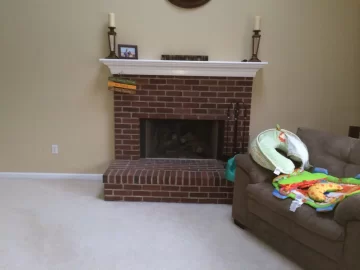

Here's a pic of what it looks like now.

That is pretty expensive. Wonder how much is the masonry work? I would expect the fireplace replacement with chimney to be closer to around $8-10K.
The least expensive alternative might be to put a rear-venting stove on the hearth connected to an insulated liner dropped down the flue. That could come in at under $4000. What is the height of the fireplace opening?

Totally didn't consider a rear vented wood stove. Height of the opening may be a problem, it's 21.5". Are there any stoves on the market with a rear vent that low?

I was going to recommend a rear exit free stander as well, until I saw the picture/your measurement. That is very short, and choices will be limited. Try to get an itemized quote, as it seems pretty high.
That is a low opening. One option would be to lower the hearth by removing some or all of the hearth brick and replacing it with a hearth that's not as high.

I once had a pre fab fireplace like yours. Eventually, I tore down all of the hallow brick wall, hearth, removed the pre fab unit, put dry wall up over the hole, made a whole new hearth, and plopped a free standing stove down onto it. I couldn't be happier with this decision and result. If you are are even somewhat handy, this really isn't as big of a task as you would think (it wasn't as bad as I though it was going to be).
Based on your picture, I'm guessing that is just hallow brick on the wall and the actual hearth is just brick around the outside with cinder blocks in the middle and should come down with fairly little effort. You could even purchase a hearth pad and put it down on the floor if you do not want to build one after removal of the previous hearth. This way, you would only need to pay for the cost of a new stove, pipe, and installation. Unless you are set on having a somewhat traditional fireplace look, I would put this option into your consideration.

On a side note, I see a lot of spirited discussions coming up with your wife when you do start bringing wood into the house. That white/beige carpet will be trashed in one season if you aren't careful. I can see a hardwood floor in your future.

I didn't notice the carpet.. Even being careful, that's going to be a mess.
