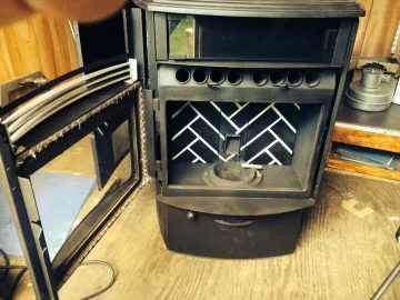

I use Damp Rid in the burn pot all summer. You can spray the fire box & heat exchanger with "Dry Moly" to keep the rust down which is much better than
cooking spray. However if you really want to go to town, I would deep clean the fire box, wire brush the rust, wipe with Emory cloth and Acetone, the use Flame Proof High temp 2,000 deg Flat Black and spray paint the fire box That makes the stove look brand new!
Pic below shows a year 2000 Quadrafire with a painted fire box that looks like new!
