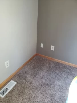

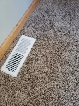

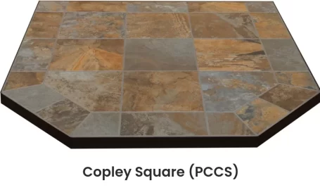

I'm going to have a 54 inch corner hearth pad put in. Unfortunately i have a vent in the floor from my forced air furnace where the hearth will extend to just about half way over the vent. Any suggestions on this? I was wondering if there is some sort of plate i can block half the vent off with and maybe cut the vent. Can the pad just go right on top?
Side note, these tile hearth pads are super expensive. Think I'm paying around $800.

It's preferable not to block off vents in a balanced heating system. There may be a solution. What stove is this for and what is the distance from the wall to where the vent starts?
The picture shown is not a corner pad.

This is for a Super 27. The pad shown is not a corner pad, but of the same style/color that i will be purchasing. I measured wrong from months ago,, now that remeasured the pad will extend over most of the vent. The vent is about two inches out from the wall and 43 inches from the adjacent wall. The pad will be pentagon shaped.

The Super 27 just needs ember protection. You could DIY for under $100. and notch it the cementboard around the vent, then tile and set the vent on the hearth edges. Or even a sheet of painted metal would work. A less expensive type 1 hearth would also work. Have you looked at the Diamond Hearth in Tartara stone? Or an American panel ember defender product?

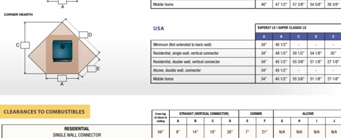

I might have to do some searching, not sure I'm following with the ember protection. Looking at the manual, I was under the impression I need my pad to be atleast 51-1/8" with a double wall.

Seems like that might be a little oversized, but maybe correct. The stove can be 4" from the corner wall with double-wall pipe. Our larger Alderlea T6 is on a 54" pad and clearances are exceeded. Where is that chart from? I don't see it in the manual I have.
I'm getting this from the PE Site. Below is the link. 54 inches is quite large. Wish it wasn't so.

Ah, it's in their sales brochure. There is some flexibility in this. Standard hearth pads vary. The Northline hearth pad diagram has 48" sides and a narrower front, but greater overall depth than the one PE shows. As long as there is at least 16" of hearth protection in front of the stove (measured from the door, not the ashlip), then it's good. That said, the difference from 51" (for double-wall stovepipe) on a side to 48" is not that great.

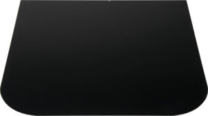

I bought a used Ember King steel hearth pad. It has some peeling and chipped paint along the edges. There is some minor rust along with some scuff marks. Any ideas on fixing this up? Id like to paint it a different color. Whats a safe paint I can use on this? This will sit on a 4" high base made of plywood and 2×4s.

It's important to use paint that won't react with the original paint. Contact the mfg. to see what paint they used. If that is not possible, try a test patch in a discrete area like the backside with a lacquer-based paint like Krylon high-temp. If no issues then it should work well.
