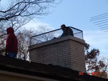

i am having a hard time burning coals i believe it has something to do with the draft (as pointed out by others and pe)
but could this be part of it
i have 6 flues up there with maybe 8-10 inches of height before the cap 2 flues are inactive, the other 4 are a woostove insert, gas insert fireplace and furnance/gas water tank coming out of the rest do you think the cap could be to close which could be a possible on why i am having draft issues?

Is this a one story house? Total height of chimney from the stove up?
yes the coals won't finish burning .. there was another thread going but it seemed to have died
is about 14-16 feet of liner we ran and it is one story (unless the basment counts) however the the stove is located on the ground level part .. as i mentioned it is only going 14-16 ft
pe says 15 ft min my installer says we did run about 16
but every morning i have a good 4-6 inch coal bed and unless i get up give it more air , move them around they eventually get shovelled out a big black coal i can not get them to burn down ... the wood i am using is dry and seasoned

As a test, how about temporarily attaching a 4 ft galv pipe extension to the flue? It will give you some meaningful results without spending a lot.
As you already know you are on the low end of the required height. That being said I have 24' of chimney and also get huge amounts of coals in the morning during cold weather and hard burning... IMO it's a blessing not a curse. Sometimes after 3-4 back to back full loads it will take the better part of the day to burn them down. I rake everthing forward and put 1 large SOFTWOOD split E/W. Stovetop temp will rise to 6-700...I am able to produce the heat I need while burning the coals down, I repeat this 2 or 3 times to burn everthing down. Start burning softwood and you will solve your problem. Agree with what craig said leave the air open more during your overnight burn, it will peak out alittle higher but you will have less coals in the morning.

i did just add a 2ft section seems to be well... not sure yet

I had Icemans coal problems last year. This year I rarely have that problem. At 27' of chimney, draft is not an issue, maybe too much draft, but certainly not enough.
This year, I can count on one hand the amount of times I had serious coal depth that hindered me. Ice, I still say slap a 4' pc of galvanized on the top, screw 2', go for 4'. See if that improves draft. As far as the coals, I think you will find that this time next year after learning more about your stove & the wood you burn, you will have less coals. I fill it to the gills, get it blazing, cut back around 500 or so, cruises to 750 and in the morn I got just the right amount for a reload. If I have a bit many coals, I open the air up all the way and in an hour Its feeding time. Not knocking you, but I think maybe not all, but some of this is part of your learning curve.
