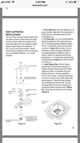

so if I understand, the ceiling kit will pass through both the roof and finished ceiling? I would bend it outward on the roof and put the flashing on top of it? so the components I've identified are good except on the exterior of the house I should go double-wall insulated?
Like this: [Hearth.com] could use help with chimney components

it's all here! luckily no damage to the stove, and only 1 of the single wall stove pipes was bent which I promptly returned. Before I open the ceiling kit, I would mention the roof above this install is an enclosed patio and the pitch is much more gradual than the "normal" roof. I wonder if the angle of the flashing is too steep for the install location.
The angle of the flashing is not too extreme and I think it will work out just fine. I'm very thankful the kit had the stove collar adapter as I didn't know that at first and thought I would have to order it separate after trying to fit a section of stove pipe to the collar direct. I think all should install smooth but my joists are 24' apart so I'll need to frame 3 of the 4 sides for the support box, luckily again the pallet wood should work out for that.
Did you download the DuraPlus installation manual?
Yes, those instructions are for chimney pipe only which one does not cut. It's often easier to use a telescoping section of stove pipe to avoid having to cut this.
