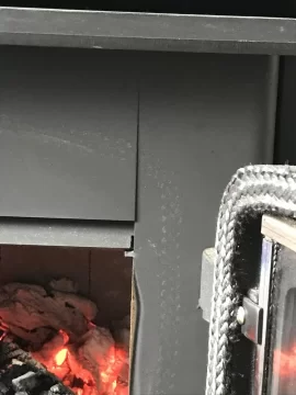

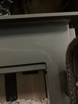

Hi there,
This is my first season with my Drolet 1800i insert and so far I'm learning to use it and really love it. Just noticed today a fracture along a seam in the front of the stove. Not sure if I call this a crack, gap, or what? Anyway, not sure what caused it, or if it's even been there since installing. I don't this the fireplace floor was 100% level before the putting the stove there or not, it may have had a bump or repair in it, but it wasn't anything major at all. Or, perhaps the heat caused it?
Anyway, is this anything to worry about? Is there anything to be done? Is this just cosmetic or will that gap let air into the firebox?
thanks,
Charlie

That doesn’t look right. I would contact Drolet. 3rd fire in mine today.

That does not look right.send some pictures to sbi today and they will get back to you tomorrow.they have awesome customer service.

Thanks for your interest. So, surprisingly, I spoke to Drolet yesterday and the guy on the phone said he'd been with the company 10 years or so and in the industry since the 80s, and had never seen anything like this before. I told him we were careful when we had the stove installed and he assured it wasn't user error. They're kicking it up to the engineering department and will likely either replace the unit of pay to have someone come out and weld that thing together. I wasn't expecting that. So, we'll see what happens next. He said it's safe to use in the meantime (I joked that I got a cheap fresh air intake). It actually doesn't show any thing through it, so I don't think any air is getting in, just a joke. But yeah, pretty nuts.
It appears they missed welding that entire joint. I’d push for a replacement. It will have to be ground out all the way to the horizontal weld between the face and the top (you can it see on my picture). Clamped back into place. Welded, Then ground off, then finish sanded and then repainted. It’s not a big job and probably something any half decent welder should be able to do. The difficulty is in the finishing and paint.
Someone got distracted and missed a weld.
From 2009 a wood stove production line
If they have never seen anything like that before I'd push for replacement as well.sbi is a good company I'm sure they will replace it.keep us posted.

In the pictures, it looks like the inside corner of the door opening is cut square. Not radiused like it should be.
