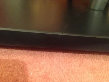

any photos?
[Hearth.com] Cracked slate hearth after new installation of woodburner... [Hearth.com] Cracked slate hearth after new installation of woodburner...
Is that carpet the slate is sitting on? Any pics with a larger overall view? You say you can look under the edge of the slate. If that is the case I'm guessing that the slate wasn't floated and laid properly, or the stove was installed before the mortar dried and it crushed the thinset making it uneven. This is all assuming that it isn't sitting on carpet.

Hello rwhite. The installer had cut away a square of carpet to put down a mortar mix. This then was put directly onto the original concrete floor of our lounge. The slate was then laid on top with an expansion gap round the edges.
He since has said it is our fault as "someone as stood on the edge of the slate and caused it to crack."
We feel the same as all of you that this is ridiculous.

Makes sense now. I would almost bet that it was not floated properly (or too much thinset) and the stove was set prior to the thinset drying. That would cause the rear to go down and pull up on the front. In that case your installer is correct, his poor work created a situation that when someone stepped on it it cracked. Did the installer set the stove as well?
Makes since now. I would almost bet that it was floated properly and the stove was set prior to the thinset drying. That would cause the rear to go down and pull up on the front. In that case your installer is correct, his poor work created a situation that when someone stepped on it it cracked. Did the installer set the stove as well?

Makes sense now. I would almost bet that it was not floated properly (or to much thinset) and the stove was set prior to the thinset drying. That would cause the rear to go down and pull up on the front. In that case your installer is correct, his poor work created a situation that when someone stepped on it it cracked. Did the installer set the stove as well?
I meant to say "not floated properly (or too much thinset)" But you get the idea, his work likely caused it to happen. He "might" have even done everything correct up to the point of setting the stove, but if you put a 600 lb stove on a fresh float job before it dries, somethings gotta give. I would bet if you pull up that slate you'll find compressed mortar under the stove and "pulled up" separated mortar at the front.
IMHO, rwhite and other previous posts have your answer on all counts. That crack clearly originates from the front leg of the stove, indicating problems with the install. Likely due to not leveling the floor and floating/screeding the mortar bed correctly. Or perhaps the mortar wasn't sufficiently cured and the weight of the stove caused the slab to deflect right in the middle of its length.
