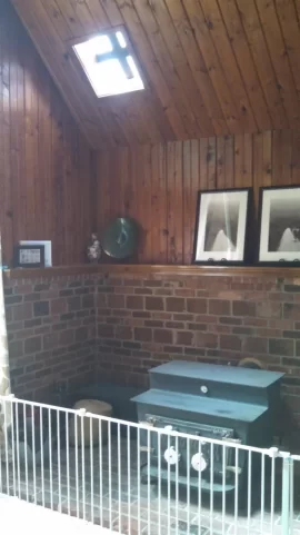

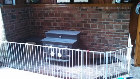

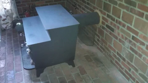

I've been lurking here for a while but am now in serious need of some advice. We heat primarily with an old Woodsman as our house only has small electric wall heaters. Today I found a crack starting at the bottom of the flue collar on the back of our stove running towards the bottom about 6" long. Needless to say that creates a big problem for keeping our house warm. We were planning on replacing this stove next summer but now need to find a replacement ASAP. The problem is it runs straight out the back and into the exterior chimney (see pictures).
We went to one fireplace dealer about a month ago and he didn't have any options and recommended either running two feet of pipe straight up from the new stove then a 90 degree elbow back to the chimney and drilling a new hole for the pipe to meet up with the chimney liner. This would be costly and seems to me there would a risk of cracking the brick and mortar while drilling through it. The other option was just putting in a new stove pipe that goes straight up through the roof where an existing skylight is. This dealer carries Regency, Lennox (Country), and Vermont Castings. I thought the Encore/Defiant could be rear vented but he didn't know anything about that.
Looking around this weekend on the web I'm finding a Jotul Oslo might be the best option along with maybe a Isle Royale? I'd really like a cat stove for the long burn times but I'm not sure that's possible with the rear exit. The middle of the existing hole for the pipe is about 24" from the floor. I'm not against running a new pipe straight up but it would be more $$$ and change the look of the house from outside. Any advice is appreciated!

Check the Woodstock site and see what the center of their pipe is for rear exit. Just about all, if not all, their stoves can be rear exit. All are catalytic, and great stoves.
If you like steel stoves the Buck 261 might work. The big issue is going to be that low thimble. It is at a custom and specific height for the old Woodsman. What is the height at the top of the flue collar on the stove?
The top of the flue collar is 27.5" off the ground. I had not really considered a Woodstock but I will now. I really wanted to deal with a local dealer but by all accounts on here they are well made.
Buck 261 may work with the short leg kit. Otherwise the Woodstock unless the thimble height is changed. Caveat, shipping to WA is expensive.

Another thought would be to have a mason raise the thimble height. It can be done correctly. That would increase your options for the Jotul F500 or Isle Royale which are both good stoves.
Measured my Oslo with short legs - 26" to top of flue. If you have 6" pipe your top of flue measurement should be 27" meaning you would have to shim this stove up with some sort of 1" block under the feet for it to work.
Thanks claydogg! It looks like with w/ the short leg kit the Oslo might still be an option. However I just measured the pipe and it looks to have a 7.5" diameter. Is it just an odd size or is 8" actually 7.5"? I really like the Oslo because everyone on here says it is easy to use and reliable. Which is good because my wife would be using it a lot while I'm at work. We also like the cast iron look. I'll consider that Buck too but we would like something more interesting than a plate steel stove to look at.

Thanks for measuring the shortleg thimble height. If the pipe goes uphill into the thimble that is a good thing. It should have at least a 1/4" per foot rise. The gap between the 6" stove pipe and the thimble wall can be filled with 3/4" stove gasket rope if necessary. Or install a 6" to 7" increaser at the thimble.

Well thanks for the help everyone! We went to a few stove shops and I think we're just going to have a mason move the thimble up two feet and ensure there won't be any draft problems. I'm also thinking I'm going with the Jotul F55. I really like the look of it and the construction.

Or just get a welder to weld up your old stove...

I was going to type that earlier... but it seemed that the decision to replace was already made... fixing a 6" crack in 3/16" or so material... put it this way.... it would take me longer to drag my stuff in and out than it would to make the weld.
but... I'm a welder by trade. If it was mine would have just welded it up and kept to "the plan".... hell, with that hearth, I wouldn't have even had to bring in the fire blankets.
oh yeah... coring a new thimble into the chimney is NOT a big deal... at all, if your contractor is properly equipped.
