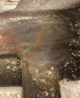

I have posted about my Regency CI2600 hybrid Catalytic stove before - I continue to be overall very pleased with it's performance. I was cleaning out ashes last night and noticed a potential crack along a weld seam inside the stove. The weld is on the left side of the stove, towards the back. It is part of the combustion air intake system and I don't believe the crack extends outside the fire box. I think in this part of the stove the combustion airtravels through these square steel tubes in order to be pre-heated before it exits the secondary combustion air tubes in front of the cat. There is also a very fine crack in exactly the same spot on the combustion air tube on the right side of the stove. Concerning or just cosmetic?
SB
jeez, I wouldn't be happy with that. Not too familiar with the stove, but if it was me, I would clean it and try to weld it myself. Then I would run it until it wasn't able to run, regardless of welding result.
BUT check your warranty, if you are covered I would try to get that fixed/replaced properly.
it is covered contact your dealer

So I had sent the pictures to the shop where we bought the stove, and they sent them on to the company (Regency). I hadn't heard anything back in a couple of weeks, but just got an email from the shop today. They have a brand-new insert for us in their warehouse and they'll get it installed in a couple of weeks! This is great, since from what I've read they've made a couple of refinements in this stove since we purchased ours. Plus we are quite happy with the level of service from the dealer - very easy to deal with.

Just to follow-up on this post... The dealer came out a couple of weeks ago and delivered/installed the new Regency CI2600 insert. There are some minor differences that I can see in the fire box compared to the old one and they are still using the restrictor plate on the opening for the "boost" air. This stove works even better than the old one! The main thing is that I find there is much more adjustability with the primary air control, specifically with the lower settings. On the previous stove I could never get the stove to shut down as much as I would like but with this one I can go all the way down to glowing coals and a red-hot cat, cruising around 700-900 degrees for many hours. I am getting easily 14+ burn times - nice constant heat output. It's really great!
