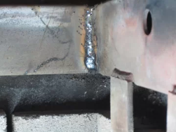

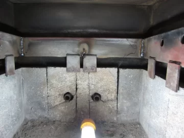

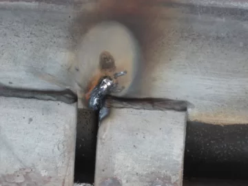

The cost for the welding was $90. I thought this was fair. It took the welder longer to get his cables out than it did to weld. He said the steel had plenty of carbon left in it as it grabbed the welding rod. This indicated to him the stove was not over fired.

Also, I am posting the pics of the cracks after the welding repair.
