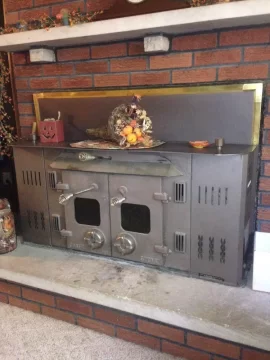

Can you post a picture of the insert for verification?
Thanks for that information. Including a picture of insert.
  • [Hearth.com] Craft Stove insert
Yes, that's an oldie.
