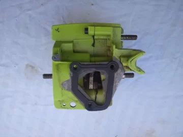

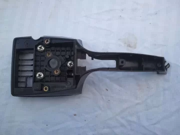

I'm with Jon that impulse circuit has a leak interfering with fuel pump diaphragm vibrating - esp if you put a new carb on it.. But this is a puzzler...the impulse circuit is merely a hole in the handle/carb housing that is open to crankcase. Is the black plastic housing cracked?
Are you sure you're getting carb impulse hole on carb housing hole, gasket has a hole there and no leaks?
I just parted out a Poulan 1800 - similar but 36.5mm piston. See pics.
Maybe it's a REAL BIG crank seal leak to disrupt impulse pressure to carb. And if so, the saw will be trash soon.
