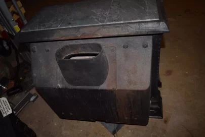

A couple days ago I was searching through craiglist and found what appeared to be a good deal. It was a Hearthstone Homestead stove with a little wear/tear for $800. I drove down and picked it up yesterday.
It appears to have cracks through the two stones on the right vertical side, scratches on the top stones (maybe they were cooking on it?), and rust on the back side where water seems to have dripped through their roof onto the stove.
I'd like to get it cleaned up a bit before bringing it into the house, so could you guys give me the recommended maintenance to do to a stove like this? Also, what is my best bet for removing the rust on the back? I have some black stove paint that might do the job, but not sure if it's the right product.
Finally, it looks like the firebricks were held in by something, but they came out easily by hand so whatever adhesive was used will need to be scraped off and reapplied. What do I need to pick up for this?
So did I get a good deal?

I've actually had limited contact with soapstone stoves but I'd go over the inside of the stove well to make sure it wasn't over-fired just to be safe. The cracked stones could be from over-firing, maybe got water on them while they were hot.... or an overactive kid with a baseball. I've never seen firebrick cemented in either. I can only guess that they used some type of gasket cement maybe?? I'm sure someone with experience with these will chime in soon.
As far as paint goes, I would check online to see what particular color that Hearthstone uses on their stoves and get that from Stove Bright for touching up the body. From what I see they use a color called Matte Black but you should check for yourself. I've always been amazed at how many different shades of black and grey these companies can come up with but it's always better to match the old.
Yeah, overfiring could definitely be the issue. The crack isn't bad, but it's there. I'm just not sure if there is a recommended repair method I should do to avoid further damage.

1) wire brush for the rough stuff, steel wool for the light stuff. Wipe clean then wipe down with alcohol or acetone. Paint with Stove Brite satin black.
2) if the crack goes all the way through and light can shine through the crack then the stone may need replacing. If not, just live with it.
3) Fine steel wool
4) Get a tube of Hearthstone cement from a Hearthstone dealer or here
(broken link removed to https://www.lehmans.com/product/hearthstone-stove-cement/)

As for the cracks, like was mentioned make sure you can’t see light through them. Use a bright flashlight in a dark room. I rarely ever see a Hearthstone that isn’t cracked... that’s a problem for me.

Are you guys referring to cracks in the body or in the exterior stone? Do stone cracks indicate stove cracks in most instances and is that a symptom of this particular stove or any soapstone stove?
Cracks in the stone. Hearthstone uses a single layer of 1 1/4” stone.
Woodstock uses 2 thinner layers of stone, and for good reason. I service a dozen or so Hearthstone stoves each season, almost everyone has cracked stones. I think it has nothing to do with abuse by the user at times, I feel that they are just prone to cracking.

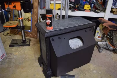

I was able to acquire some Stove Brite in flat black. After a wire brush hooked to the drill as well as some steel wool to get into the corners, I applied two coats and I think it came out pretty nicely. Below are the before and after pictures. Thank you begreen and webby3650 for the cleaning and paint suggestions.

Oh and I forgot to mention that two of the bolts on the back were rusted solid so they broke off when trying to remove them. I had to drill them out and use a Speed-Out to remove them. Fun times!
