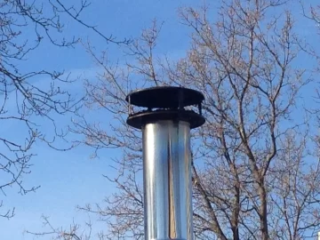

Speaking of dirty caps and at the same time not trying to highjack this thread. should I be concerned with the amount of build up? It is a very exposed chimney in a cold climate.

I myself would not be worried about it , you are going to get some buildup. As long as its not big flakes , shiny flakes , I'd go with it and check it in a month.
You need to get up there and take a look , brush it down while your up there . Take some pictures while looking down the pipe.
I would be concerned. By my eyes, looks like a ton of chunky pcs laying on to of the lower lip of the cap. Put an eyeball on it and might as well clean the cap and check the pipe up there. If built up, clean it out.
