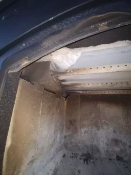

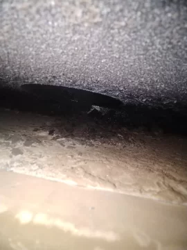

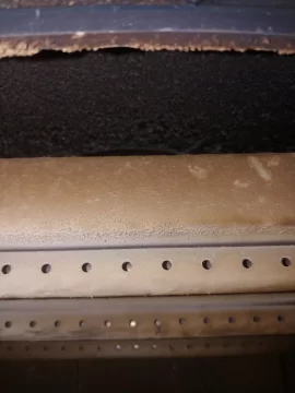

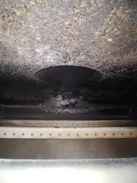

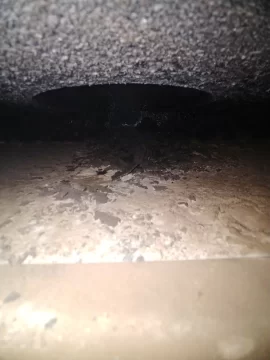

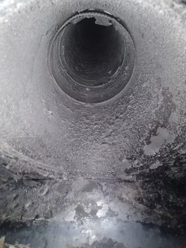

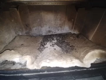

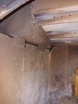

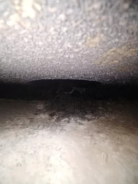

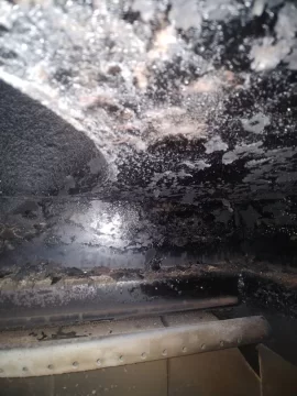

Alright I've been burning for a month or so and wanted to inspect things a little ..ive had constant fire going for about 2 weeks and before that it was every day and all weekend kind of thing. I'm pretty concerned with the buildup and then I went and broke the damn baffle. Is that baffle still useable since that area is covered by the stainless steel baffle that goes in last? The corner peice that busted still sits in there fine so I dont see it being a large issue but what do you think? How about the buildup, do I need to be concerned? Sorry for the duplicate pictures.

Fyi this is a heatalator constitution. Sorry that should have been in original post. The buildup/flakes are very light and fall off with just a touch. I bet my shop vac would suck them off without even touching them
Looks pretty shiny in spots but I dont think ita very thick. All those flakes on that blanket though, is that ok? Just seems like that'll build up and catch fire

I guess I’m comparing to a neighbor who had large shinny and some sticky black clumps and flakes raining down the inside of her stove pipe. Yours, for the most part, looks grey and fluffy.

Yes grey and fluffy. But some shiny areas. Zero sticky stuff. There were the flakes raining down which collected on that blanket that sits above the baffle. And this was only after 1 month.

You starting with paper? Nothing you posted looks too bad IMO. You have it apart but you can wait to sweep if you want from what I see. One guys opinion.

Thanks. I cleaned what i could and just got her going. From my research it seems like I probably had a good hot fire with a really good draft which then carried those out the chimney. I do not use paper to start it. I can tell it is the exact same stuff that i saw from inside here. Very light and crumbles instantly when touched.
Get that sometimes off the cap. As long as the cap is clear you should be good. Use binoculars to check if you're not sure. Soot eater is a great product BTW.

If you sweep with the soot eater I don't think you need to have it done professionally...unless you think you got some stage 3 creosote. That you can't remove. My opinion is run the soot eater and see what you get. If its brown ashy, great. If its black shiny, ok but burn hotter. If the soot eater head comes out with sticky tar call a pro and figure out how to better dry your wood.
