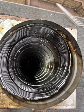

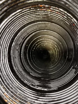

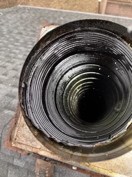

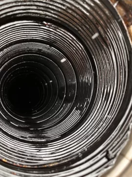

photos from down the top of the chimney. So definitely has an even coating of glazed creosote down the whole thing. However it's not super thick. I scratched through some with my screwdriver, and it's about as thick as a coating of oil based paint. Maybe a mm or less.
How do we feel about burning now?
Also, how on earth do you clean this stuff, no way is a sooteater going to scrape this out of the valleys in the liner. Is the Creo log the best thing?

I think you'll be fine to burn the rest of this year. The above advice is good.

Thanks. So what would you recommend for removing the creosote glaze I have? Would you agree that my sooteater is really not going to do much on the smooth glaze?
A rotary cleaner will probably get most of it off
Reactions: tabner
I'd just pull the cat and burn the log. Then brush the pipe. Run a small, hot fore after you're done cleaning if you're worried about residue.
