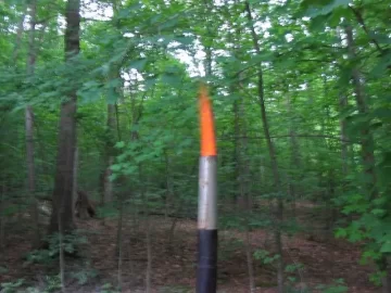

Flame impingement is the most common cause of chimney fires. Pipe gets a coating of creosote in the connector pipe or chimney smoke chamber and flame gets to it and it is off to the races.
I did this with my old insert in the back yard a few years ago to show you what happens in the pipe when you toss those pizza boxes in the wood stove.
looks like the North Korean's first attempt at an icbm , guess they didnt put fins on the rocket <>
That is one clean burning fire.
