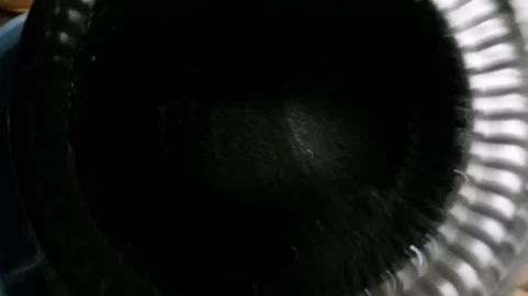

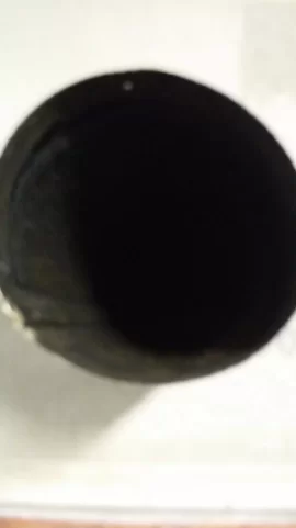

Hello Guys,
This morning I decided to finish the instal of my CFM - FW240007. I notice a lot of dust/creosote in the 90 degree angle going to the chimney. Is it due to the fact that I placed a flue key on the pipe underneath the elbow?
I have included some pictures so you see what I am talking about.
Thanks for all the comments.
Damien
PS Lucky that is is 60 degrees outside today. Hope to have the stove back up and running by tonite since it will be in thirties tomorrow.

Damper or not creosote will accumulate (if any anywhere) anywhere the is a restriction or elbow. That is why folks try to get a strait run or use a "T" connector instead of a elbow so that there is no place for that nasty stuff to accumulate. I'm sure others will chime in with more insite on how to help you with your set up.
your pipe looks like mine except your creosote looks a bit wetter.
Single wall horiz runs act like a radiator, rapidly cooling and slowing down flue gases. If you can, try to increase the upward angle of the pipe toward the chimney. It needs to be pitched at least at 1/4" per foot, but go more if you can.

Whats your wood situation? Dry wood? getting lots of smoke?
The wood is dry (less then 20% after a split) . I know what the problem is last week I burned a lot of card board and paper.
I know now it is a no no.
Damien
How much paper? Enough to create all of that in your pics?
It was a lot. By I also believe is the damper on the pipe was closed a lot and the secondaries were not working.
I cleaned the pipe and i will check in a week and they if it is better or worth.
The flue pipe now is a 300 and the top of the stove at 550.
Any suggestions are welcome
Damien
