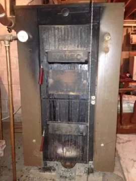

Back in the early 80's we had a boiler like the one in the picture below , it would heat your hose but its real specialty was making creosote .
[Hearth.com] Creosote Issues... Help??
