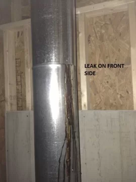

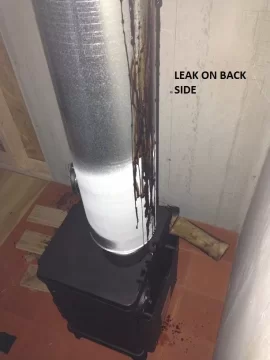

Anyway, today at one point when getting the fire going, I smelled a foul smelling chemical odor which made me feel sick. I didn't see any smoke, and I heard that with new stoves you might get a smell from the paint curing, but I figured there might be smoke leaking through the seams in the stove pipe. I kept the fire running for another 4 hours, and at one point returned to the cabin to find a lot of brown/black sludge leaking from the middle of the stove pipe about 4 feet above the stove -- running all the way down the pipe and dripping onto the stove and floor.
I'm guessing this is creosote?
It smelled terrible and I put the fire out immediately.
A couple notes -- I was burning seasoned oak and maple. The stove pipe temp was between 300-500 degrees. The outside temp is cold today -- 20 degrees with strong wind gusts up to 40 mph. One of the windiest days I can remember in recent history. The smoke coming out of the chimney was running horizontally.

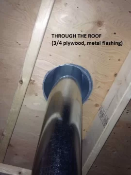

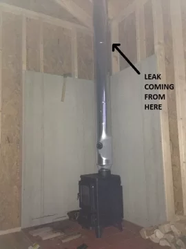

The chimney setup is: Stove > 4"->6" adapter > 2' galvanized pipe > 2' galvanized pipe > 5' galvanized pipe (going through roof flashing) > chimney cap

I could be mistaken but I think your pipe is upside down....it does not go together like an exhaust on a car for air flow it goes the other way for creosote to go down with out leaking like it is...others will chime!
You need to ditch that galvanized pipe fast and get some real connector pipe and Class A chimney. You are asking for trouble if you don't.... such as burning your house down and/or poisoning yourself. Also male end down.... always. Otherwise creosote will leak out of the seem, down the pipe, and burn.
You need to assure your family member they are not allowed near any heating appliances from now on lol, and go back to the store that sold you that stuff and have that employee fired.
I second RockyMtnHigh's advice. That creosote leaking onto a hot stove can prove disastrous! Can't afford to cheap out on chimney parts without getting into trouble. You might want to double check all your clearances on the stove and pipe while you're at it. If that pipe you are using is single wall it looks awfully close to the ceiling joists.

pipe is upside down and wrong pipe as said above. Don't burn it any more like that

The creosote is a result of the uninsulated galvanized piping, and most likely wet wood.

And for sure that wood is not "seasoned" else you would not have that creosote problem already. But that installation sounds like a total disaster. I would not recommend burning any more wood until that is fixed right. And use black pipe indoors. Outside you need some insulated class A pipe and 9' total for a chimney usually won't get the job done either.

Besides the pipe issue, I'm concerned that you are getting any liquid creosote at all. After you get the pipe situation resolved, take a close look at your wood, get a moisture meter and use it on a freshly split face. It needs to be 20 - 25% moisture content.

Besides the pipe issue, I'm concerned that you are getting liquid creosote at all. After you get the pipe situation resolved, take a close look at your wood, get a moisture meter and use it on a freshly split face. It needs to be 20 - 25% moisture content.
Yeah, I was very surprised at the amount of brown liquid leaking out. The wood has been sitting in a garage for 1 year.

Male end always down as BG pointed out. Then all that creosote from that wet wood will stay in the pipe and run down into the stove, instead of all over the outside.

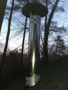

Up top outside, when you run the right pipe, make sure you get a storm collar for it also. Just siliconing around the flashing to the pipe is asking for a leak.
And use the proper sized 6" pipe. Stepping up to 8" is only going to create draft issues.

You will need a new flashing as well... that one just won't be large enough for a class A chimney, no big deal though. Go to a qualified hearth retailer and they will set you up properly. Glad you made the thread before something terrible happened.
That appears to me to be 8" pipe, which would be the OD of 6" class A.
