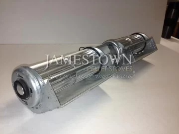

My crossflow fan in my stove is squealing at certain speeds. It's the 2nd one I put in since owning the stove for 3 years, this one is less than a year old. Jamestown doesn't have any plans to get any new motors in since I am the only one that needs one at the moment, and I know they have to buy a lot of 50 at a time. There is no oil ports on this fan, and I have removed some bearings and oiled but it didn't help. They sent me a fan that is used in the older model J-1000's but it was very under powered and barely blew out any heat. Can anyone help with cross referencing this fan for me or pointing me in the right direction of an aftermarket part I can buy. Thanks

What brand blower is it?
Don't know about bedside manner......, but thats a Fasco axial flow. Goggle up Fasco fans, I know WWGrainger stocks them You can go buy phsical dimension and CFM delivery. I believe Fasco also has a website but they won't sell except for commercial application.
Additionally, what you might try doing is pulling the end housings and putting a bit of petroleum jelly on the outboard sleeve bearings. That will help alot.

Jamestown will send a new one to me because it's less than a year old, but they don't have any in stock, which is really aggravating to be honest. They also don't know when they are getting motors in since I'm the only one on the list at the moment.
I put motor oil on the bearings on the original motor that came with the stove and it didn't help, maybe I will try the jelly. Thanks
I'll check it out thanks for the info.

Every manufacturer uses off the shelf parts. Fasco is a big supplier. The only thing the OEM's do is fab the shells and internals in a weld shop. All the components are sourced outside and I suspect the shell and HX parts are also contracted out. I do that for my business as well. Why invest in a 3/4 million dollar machine when you can get open time on someone else's machine.
Also keep in mind that the drives (with the exception of the combustion air blower are all similar) in design so keeping one extra drive on hand will fit 99% of every application. Thats what I do. I have one drive in a box on the shelf. If a drive goes down, I swap one out and rebuild the failed drive.

Thanks for the info. I know the fans they were using the company went out of business, so they are now getting the motors from Baymotor Products in Michigan. I called them and they said they couldn't help because it wasn't one of their motors. They are the ones who told me about the 50 order, Jamestown said they didn't know how long it would be before they got them in, but that's the reason I'm sure.

I know it's been a while, but figured I'd give an update. Jamestown came through and found the OEM fan that I needed, sent it to me and all is good with the stove now. Thanks again for the help.
Glad to hear you got the fan ... should still try to see if you can cross reference to another fan JIC. How long of a wait?
Good idea Lakegirl, at least I have piece of mind while doing it and I'm not under the gun looking.
