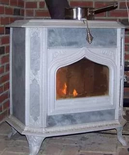

Hi everyone, thank you for all your replies. I am posting a picture of both my new cumberland and my fireview. :) I've gotten to use the pellet stove a couple of times so far (although I didn't absolutely NEED to, I just wanted to. ;)
The pellets I got from Lowes were Inferno's. They are all mixed sizes in the bag though, and the smell isn't unpleasant for me, but my kids said they smell "weird." I will note that I have to work the kinks out of the Cumberland-finding which ranges work best at what temp, etc. Good thing I have all summer, huh?

Inferno's are a Horrible pellet. Any other pellet (Pennington Nature Heat/sister pellet) Is money well spent. Those are the 2 lowest BTU rates pellets out there. Good luck and Nice Stoves. Love the Hearthstone line. All are beautiful...

OH, and BTW, great looking stoves!
Nice Stoves! Mines just plain black, I like the gold high lights. It's probably going to be hard to judge how well those pellets will perform in the off season. The truth will come out in mid January.
