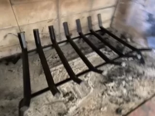

Anyone build your own log igniter? I am looking for a longer one than I have found online. Any suggestions?
I am thinking about duplicating the hole spacing and hole size on a store bought one but making the gas outlet holes on both back and front of the pipe.
Capping it at the end with a regular end cap.
Open to any suggestions or shared wisdom!
  • [Hearth.com] Custom Log Lighter
As long as you used the factory air mixer I can’t see an issue with it. It’s just 3/8” steel pipe. Instead of just capping it, use a 90 and a short nipple with a cap so it has a leg to hold it up. It will last longer this way.
