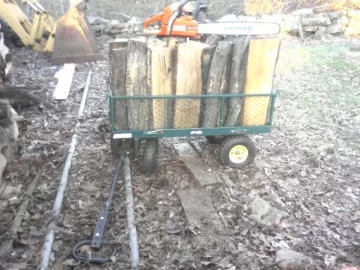

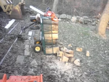

Had the same issue when I changed stoves, exactly the same issue. Most wood was 22-24 inches and large splits. While I did not change the split sizes, I did cut down the length using my garden wagon. See pics. Made it a one step process; load wagon like normal, cut in wagon and bring to house. I would use a wagon load a day. Had the ability to store 2 days worth at a time. That meant I was cutting every other day. That may sound like a pain, but I liked keeping the saw in fresh condition. The stubs make for great warmer temp fuel. They dont burn as quickly due to the fact that the air can't find a straight path to run down. I have 10-15 more cords to do this to. Ran my garden wagon into the ground though; bearing shot on 2 wheels, steering linkage junk. Would not buy one again, but would make a similary unit that could handle the load.

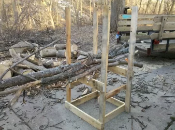

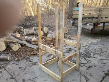

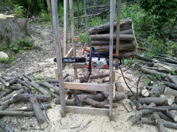

Make one of these. I made it about 2" shorter than max, in case I don't cut straight <>

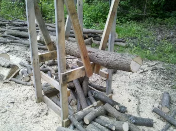

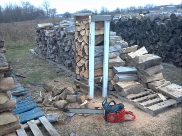

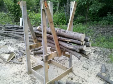

You can make the Same basic thing I made, just make it smaller, made this from pallet wood
