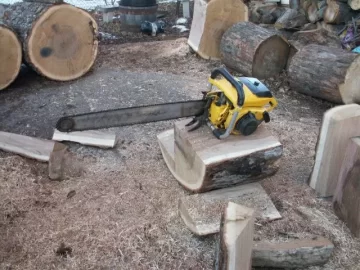

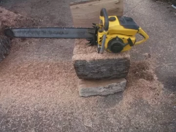

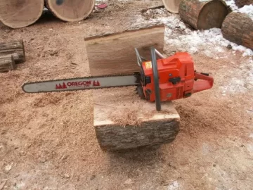

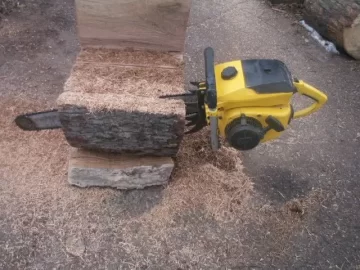

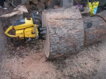

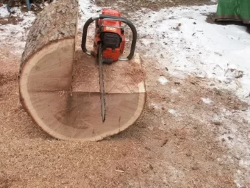

White Oak 30" to 36" diameter December 2013 - January 2014
  • [Hearth.com] Cutting Large rounds along the grain
Reactions: firebroad
Excellent. These rounds are a good 36 to 50 inches across. I'd love to bust them up without have to chainsaw them.
Thanks!

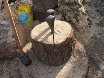

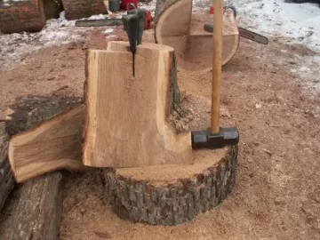

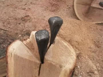

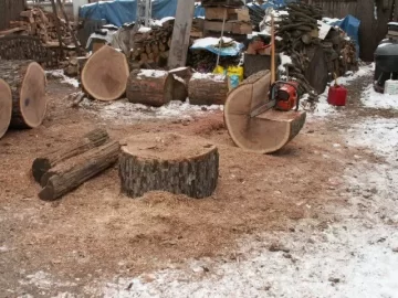

2 wedges started with making a 1" indent on each side of the round using the chain saw, and then an 8 pound maul works really well for me....
