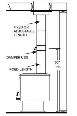

The ultrablack by ICC recomends that the damper be placed 18"-24" above the stove if i remeber right and in your case the easiest would be to put it at the top if you can reach it
Double wall pipe. This should be ICC part # UBD
(broken link removed to http://www.icc-rsf.com/main.php?t=chem_produits&i=37&l=en)
Ohhhh, gotcha! Thanks for correcting. Said like Gilda Radner: "Never mind!" :)
It comes from ICC in a short length (4 inches?) which I figure I'll install at the top of my adjustable, which will shorten the adjustable pipe by 4 inches....
It would have to go in a fixed section or the adjustable wouldn't be very adjustable!
Both the top and bottom of the adjustable have about 3 or 4 inches of "un-adjustable" pipe that could easily accept a damper. I might do just that, so I can close it down when I'm not burning the stove...
