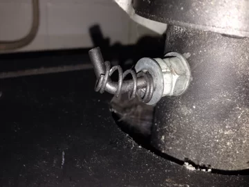

I just bought a house with a Magnum Baby Country Side in it. The damper is loose and the spring is just flopping around on the control rod. Consequently the damper just falls closed and I have to tape it open. You can imagine I can't fine tune it either because of this. Does anyone have a picture or advice on how it is supposed to be installed properly? Thanks!

After watching the video a few dozen times I finally figured it out. That spring is supposed to be putting tension between the damper shaft handle and the stove outlet. That spring is to short. Either stretch the current spring out some, or go the the hardware store with the old spring and get one that's longer. Your want the spring long enough so that it's putting tension on the damper shaft handle. I hope that makes sense.
Ok. Thanks JDenyer, that makes sense. Bases on that I went for the spit and duct tape approach. Actually, nuts and bolts. Works like a charm. Problem solved. Now all I need is the cast iron burn pot I ordered and I'm golden.

Figured it share tech support's response. Nice that they got back to me. Might be a more sophisticated way than my nut and bolt rigging:
"Greg, the reason it is doing this is the keeper that puts the spring
tension on the handle is gone and the spring is loose. If you can get a
small hose clamp from a hardware store and put over the shaft and put
tension on the spring that will solve it for you."
