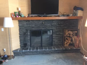

Here is a picture of the fireplace and hearth
We have a TV on the hearth now, but will likely move it until we determine what the temps will be when the insert is burning

I haven't followed the whole thread but 3 things:
1. I have my TV over my insert, no problems so far (3 months) . It is wall mounted to brick. I have a mantel that extends over it. I have an IR temp gun (amazon about $12) and I get low temps near TV.
2. You may need a permit in your area from bldg inspector. Also your homeowners may or may not need notice. I have state farm they wanted a receipt showing a pro install, and photos of it. no rate increase (they already knew i had a wb fireplace.
3. Clearances. Check your manual, but you'll need 18" or 16" and 2" raised (which it looks like you easily have) from the front of the fireplace. Given you have carpet there I'd highly recommend a non combustible pad in front, to be overly cautious. You can buy a pre fab or make you own with like hardy board and tile. There are clearances for the mantel height for its width, etc. Also side to side. Read the whole manual before the install so you're familiar with the insert as your doing it. I included the tape measure showing in my pics to my homeonwers agent . Just me being cautions but my good friend burned his house down refinishing the hardwood floors he put the hot sawdust in garbage cans outside garage whole house caught and burned. total loss. It was HELL for him getting a payout, investigated for arson, living in an apartment with the family etc etc. This was 2008 after the economy tank and they looked at him hard.... I am overly cautious about house fires after seeing that.

Thanks for your comments. That is a good reminder of the risks of home fires- doesn't sound fun.
1. good to know that your TV on the mantle looked OK- I've got an IR gun coming as a few others had recommended that type of thermometer for inserts, so I'll use it on the TV as well
2. I gave a heads up to the homeowners association- they had no problem with it as it is professionally installed. Sounds like no permit is needed (installer said only Burlington in VT is where permits are needed around this area). Next hurdle is the insurance- I'll save the receipt as you had.
3. I may try the DIY version of tile on hardyboard for the hearth extension pad. Does this pad need to have an R value, or just be non-combustible? I believe it is the latter, but please let me know if you think differently.
