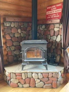

Is your raised hearth built to meet the Woodstock hearth insulation requirement?
Yes, it's entirely non-combustible. Steel studs, durock and a piece of slate atop the durock.

The raised hearth was here when I bought the house, but I agree, it will make loading/cleaning the stove easier, in addition to making the fire-viewing a bit better. The couple who built the house ~15 years ago still live down the street, and it's been pretty great to be able to ask him questions about the place.
Here are a couple of photos of the existing setup. Excuse the mess (and awful curtains, they came with the house!) in the photos. I'll be cutting out the hardwood and laying down a couple courses of ceramic tile to provide a non-combustible floor surface under the door swing area as well.
I went with an Almond color body and Surf Sand accents on the IS, which I think will look really nice with the hearth.
