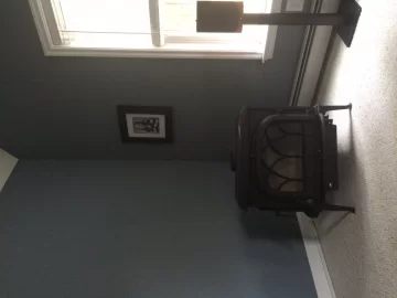

I've decided instead of buying one of those prefab hearths I'm going to build my own. Too expensive for the prefabs. I have a question about the design and I'm hoping someone can help. I have a Jotul Oslo 500 and the manual states I just need to have a UL1618 Type 1 Ember protected floor. I have carpet there now so I'm going to cut it out and I'm hoping I can just get away with putting a 3/4" piece of plywood, then a layer or two of durarock then either tile or slate stone on top of that. Is that adequate for this stove based on the info I gave you? Don't want too much height i'm okay with 1.25"-1.5" thick hearth but that's about it.

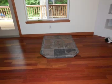

I did this guy with slate over a 3/4 inch piece of furniture grade plywood. Clearly my foundation is combustible so I'll have to keep an eye on the grout to make sure it remains in good condition.
