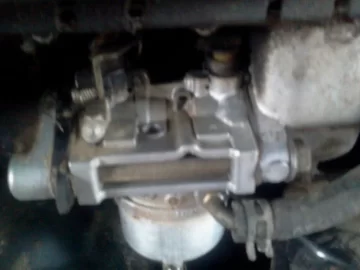

This is the carb on my deere 165 hydro. Whenever I back off the throttle, gas pours from the top of the carb. There is a hole in the top center (am I missing a jet screw there?). The gas pours from the hole just to the upper right of the center hole.
I have the carb IPL and this one really doesn't match the picture :eek:
Am I just missing a screw or is something else going on here?

Float may have come off its hinge, or sunk. Pull the bowl, and have a look! Have something ready to catch the pesky little float hinge pin.

Float may have sunk or is sticking. Pull the bowl and take a peek. May as well clean the jets out while the bowl is off. Like Joful said, have a rag or paper towel under the bowl to catch the important bits.
Rebuild kit. I chased problems in mine for a year.
Bret is right on. Problem is only when the throttle is initially closed? Assuming the tractor will otherwise start and idle fine, that's a plugged vent. Should be either a metal elbow that's connected to nothing (it might have a short length of poly hose on it, it might not). Or a very tiny hole in the top of the carb casting somewhere. Spray it down with carb cleaner and go hunting for it.

It happens after the tractor is started and I reduce the throttle. I don't think it does it at WOT

I dropped the bowl and found a bunch of debri floating around. Sprayed everything down with carb cleaner and made sure the float wasn't sticking.
Seems to have done the trick (fingers crossed).
