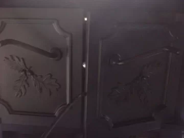

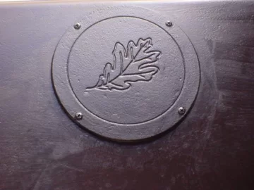

I just finished painting my old Country Comfort with Rust Oleum satin black.
Is there a high temp detail paint for the raised oak leaves and other details to really make my make-over pop?

Here are a couple crappy pics (camera battery about dead so no flash)
  • [Hearth.com] Detail paint for woodstove
