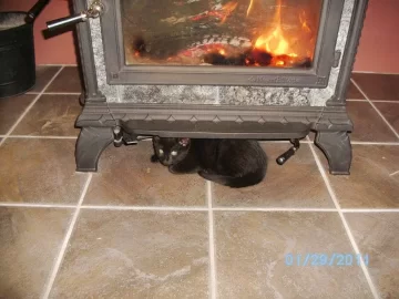

Yes, I shoved about 30 cords through a heritage that I bought new sometime around 2008. It was the previous model heritage with the side swinging side door and my home is only 1700 SF. The stove did a good job as our 24/7 heater for a non-cat. It did what the advertisements said it would. Barely, but dependably, made it through the night without needing a match to relight. Kept the 1963 house warm in single digit temperatures burning softwood.
The current model heritage has upgrades which address most of the problems I had. The side door hinges are now on the bottom so hinge wear should not be a problem, the cast iron frame has replaceable inserts where the door latches catch which are way easier to replace than the whole side of the stove. The remaining problem that I can see is the front door hinges, they are very dainty and expected to carry a lot of weight and maintain a very tight tolerance so that the very skinny door gasket meets up. That still is a weakness but if you never use the front door (which I never did except for cleaning) it may last quite a while. The front door frame could be replaced without a total tear down but it's expensive.
I never cracked a stone in all of my years running it but I am a stove nerd and carefully monitored stove temps, never approaching the redline of 550 as I recall.
(broken link removed to http://www.chimneysweeponline.com/hsherit.htm)
I moved up, upgraded, to a fully loaded BK princess. It was no more expensive than another new heritage. In fact, it was cheaper. I got that BK for under 3000$ out the door including our 9% sales tax. From the link above, I couldn't get the heritage for that little. The BK is far superior in terms of burn time and efficiency. It's a much better heater for 24/7 house heating in an area like mine with a 9 month burning season.
The heritage was a much prettier stove with an excellent fireshow. It just wasn't durable enough and replacing the wear parts impossible without tearing the stove down to little rocks.
