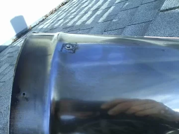

I've been burning year old oak and have been trying to burn it hotter to avoid creosote build up. I've only been burning 3 weeks, but my chimney has gone from brand new to this (see pic).
There is build up on the interior of the rain cap and part of the circular metal rim is bent a little. There is also discoloration on the exterior of the pipe itself.
Is this... normal? Or am I playing with.. err.. fire?

I'm no expert, but you can never be to careful. I would definitely run a brush up it, just to be on the safe side. That should give you an idea of how much is actually being deposited inside the pipe. I do know that others will chime in and tell you year-old oak is not ready. 2-3 years normally. Heck, I'm burning 2 year old elm that sizzles and hisses.
Reactions: hobie1canobie
Your cap looks pretty dirty from your photo. Can you get a good look at it with some binoculars? I'm fortunate that my roof is easy to get onto and I have easy access to my chimney/rain cap. When I have any questions it just takes a few minutes to get up in the roof and check things out. If you can get to your cap I'd suggest going up top and taking a quick look to see what you're dealing with. If the cap is getting clogged up you can at least pull it off and give it a good cleaning even if you can't do a full sweep right now.
It is possible that it is a cap only problem. The cap being the coolest part. BUT the only way you will know is to inspect it and/or sweep it. It is always advisable that a new user sweep more frequently till they get a handle on what is happening (or not happening).
And to answer your question: No, I don't consider that normal. It deserves attention.

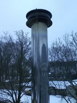

I also have similar discoloring on the outside of the chimney on the top couple feet. I was told it was normal and was due to smoke on reloads. Sometimes it seems as if it cleans up a little on its own after a rain event.

The last chimney pipe looks like it experienced some extreme heat just below the cap.
Mine looks worse then that! But i havnt been able to get up to mine for 2 months. The discoloration just wipes rite off, its not from extreme heat.

Mine looks like that all the time and I never have any real creosote in there. One good rain and it looks shiny again. It's still worth checking it out but I wouldn't worry too much. Please report back about what you find.

Looks like a Selkirk set up. My Selkirk cap came with a heavy coating of oil on it. Turned black like that within my first couple real fires, I attributed it yo the oil burning off OR the stickiness of it catching all the soot and coating itself.
My pipe also has same discoloration at the top. I've swept from the bottom twice and not much creosote either time and an overall clean looking pipe.
My neighbors is the same....

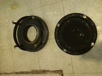

I got up there today and it looked like only the cap had real build up. I took it apart and got the big stuff off. Pic is before cleaning. The dirtiest part was the top, and it is the coolest/uninsulated part of the cap. I suppose this makes sense.

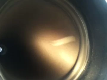

The discoloration on the outside of the chimney pipe, as some of you suspected, was able to be cleaned off. You might be able to see a cleaned circle area in the pic. But it didn't come off easily, so I just left most of it. Inside the pipe it was fairly clean. It reminded me of wiping your finger on the top of the refrigerator - I could swipe a finger print but that was all. The pic actually looks dirtier than it really was because it is a blurry camera phone pic. The flue pipe was a little dirtier, but it cleaned up easily. Maybe about a 1/4 cup of soot from a 4 ft of flue pipe.
I've ordered a Sooteater and will send it up there as soon as it comes in, but I feel comfortable to burn until then.

Thanks for the good pics. If that was my pipe, I'd feel good to keep burning, as there didn't look like really much there to combust. (If you more experienced burners disagree... by all means, pipe up!).
