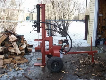

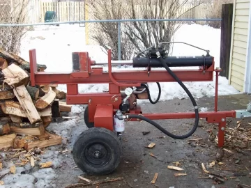

Didiers came with a 5hp b&s;, yours is overpowered UNLESS the pump has been upgraded. They also used a 4" cylinder on top of a 4" wide beam. Here are a couple pics of mine after some major modifications. The engine has since been swapped out for a 5 hp honda. Overall, I've got a few hundred bucks invested in mine and am satisfied. From time to time I'll run into a big nasty piece that won't split initally. With a little patience its been able to split everything I've thrown at it. They're good, simple machines. Do yourself a favor, get it up to a comfortable working height asap. You'll enjoy using it a lot more.
  • [Hearth.com] Didier Log Splitter
pic2
Looks like a nice splitter BN, but are you missing a dust cap on the trailer wheel? Looks like the axle nut is showing... Probably not a bit deal if you're just pushing the unit around the yard, but could be a problem if you were towing it...
Gooserider
you caught me, dust caps got lost during the "makeover". Its never been pulled by anything but my own hands so not a real big deal at this time. Thanks for pointing that out, reminds me to pick up a couple dust caps next time I'm at TSC.
