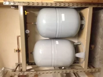

Went with the black iron and copper male adapters. Hoping this will work better than my air charged compression tank.

They are Xtv 100, the label says 53 gallons. I think the acceptance is around 32 gallons.
Test run last night my start temp was 68, I might have to drain off a little to get to the temp/ pressure I normally run.
gg
Took storage to 182 top 160 bottom was at 22 psi. Temp at expansion tank was 160 during burn.

gg, you piped them up exactly how I'd have done it, black reducing coupling with copper threaded into it! Nice looking job, I like your shelving too.

Thanks! hopefully I can get it all working properly after a good air purge.
