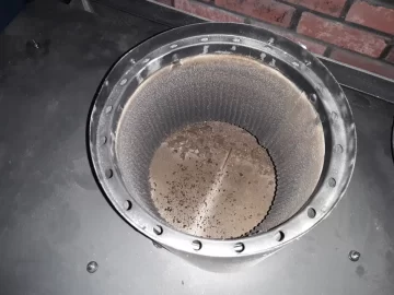

Out of curiosity, my most likely place for creosote buildup should theoretically be the cap and section of liner above the masonry cap, right? Furthest from the heat source and most exposed... If that's got much buildup I'll clean the whole system, if not maybe I'll just keep an eye on it. I'm only 3 days into this less seasoned wood, so I don't expect too much buildup. I've been burning fairly hot - at least 400STT. Just a little concerned about the slow starts on some of the overnight loads...

So I inspected my liner and decided to clean it even though i didn't think it was bad. See attached pictures before cleaning. The cap had some buildup on the screen and there were some flakes up close to the top. The rest I would consider more "soot" than creosote. I would like comment's from you more experienced guys. This was all installed Jan 23rd and hasn't been cleaned since. The first week I was slowly getting brave enough to get to the recommended temps - previously being a smoke dragon guy, that's a scary temp difference. The last few days I've been struggling a little with not great wood, but still trying to burn as hot as I can. After 9 weeks of nearly 24/7 burning would you consider this fairly normal or a lot of buildup? I would say all total I have about 3 cups worth of creosote and soot.
That doesn't look too bad at all.
