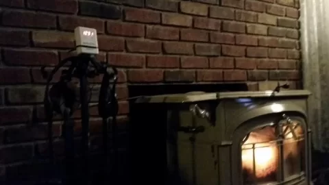

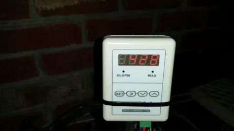

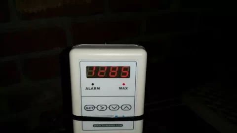

I replaced my condar digital monitor last week after having problems with at temps. The monitor quit all together so I decided on trying the auber AT100 and using the 4 inch probe from the old condar.
I immediately noticed a great improvement in controlling the stove. Now I feel like I have different stove that performs well. I may have had a bad condor but the auger stays on all time and works great.
