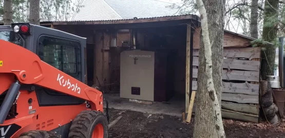

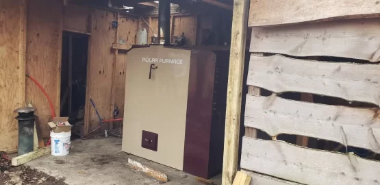

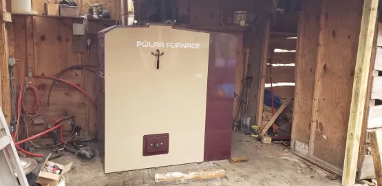

I replaced my second Pro-Fab Elite 200 with a new Polar G2+ mid January. I love the new Polar, it is better than I expected.

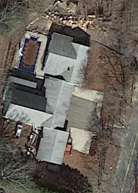

My hot boiler water comes into a manifold after a Grundfos pump at the boiler, 100+ foot run and another Grundfos pump just before the manifold. It then splits off to heat 2 different oil boilers in separate basements with plate heat exchangers. Each has a Taco 0014 to get that water back up the hill into the boiler. Along the way to return from the big house I have 2 closely spaced Ts that let the cooler water go off to heat a 1200sf second story apartment with a 3 zone radiant floor system. It goes through a temperature control valve to limit temps to 125f.
There are many places along this system that it would be nice to monitor temps. Maybe I could find that the pump at the manifold is not necessary, who knows?
