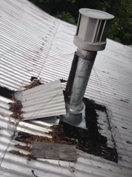

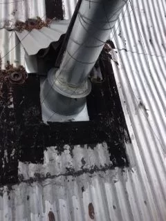

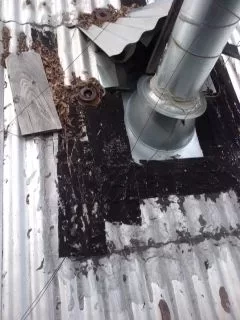

Should I just slap another coat of henrys down and call it good?

None of that looks right!
Inside the t&g ceiling is touching the pipe
flashing on top of the corrugated tin roof, henry's tape to seal
bent in the attic, pipe very crooked, pipe touching roof sheeting
bailing wire supports
but other than that its in good shape!
