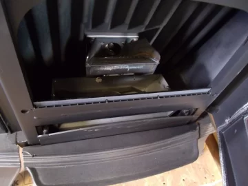

Woodnut, I have a very similar problem with my XXV as well. See my pictures and read my issues here:
https://www.hearth.com/talk/threads/xxv-airwash-reducer.82008/#post-1232529
Once I clean my whole stove (everything), the glass gets these very distinctive streaks on them in a matter of a few minutes after the cleaning is done, and I am also burning very decent pellets too (Turmans), so I doubt it is because of the pellet quality. I also have a friend that has an XXV, and he burns some really cheap pellets, but he can still go about 4 days to a week before seeing soot on his glass. I have done the dollar bill test around the whole door also and the door gaskets seems to be fine with that test, but from the looks of the streaks, it appears like either air is leaking in around the door gasket and might be causing a disturbance with the air flowing out of the airwash therefore concentrating the soot in these areas, or a malfunction in the actual airwash itself. My stove is also practically brand new since it was just installed 4 months ago in October and only 2.5 tons of pellets have been through it. I noticed this problem though from day one.
Besides that though, the stove is running fine. So I plan to deal with it for now and wait out the season until the pellet dealer's technicians are slower, and then I plan to call them to come out and figure this thing out for me before the warrantee runs out.

Thanks Eric. I would agree 100% with you that the glass should be wiped daily, but I find it hard to believe that there would not be a component issue (with either the door gasket, the airwash system, or something else) since these streaks form and are very noticeable after only 20 minutes of use. You can actually faintly see them starting just after 5 minutes of burning after a complete wet wipe down of the glass. If this didn't happen so fast, then I might think it would not be a component issue. Also if everything was working fine, then why would Harman spend money on engineering an airwash system if all it bought you was 5 minutes of clean glass? I know if I was the owner of Harman and my engineers told me that they designed an airwash system that would keep the glass clean for 5 minutes, I would either tell them to go back to the drawing board and get that time increased to hours, or forget it completely and not waste time and money on putting this into production for a measly 5 minutes of clean glass. Not worth it.
streaks in the airwash after five minutes is an air flow issue. It can be as easy as the air was being blocked at this part or further into the system. It can be as complicated as a lack of air flow into the stove or a blockage in the venting. With something being "broken" in the stove to cause dirty glass I do not know how that could happen.

I agree. I just do not know enough about the airwash system to correctly diagnose this as the issue. But since it has happened from day one, I don't think it would be caused by a soot, pellet debris, or ash blockage, but maybe a mechanical defect by not getting enough air to start with from the outside? I know during the last cleaning I stuffed a pipe cleaner down into all of the airwash holes to try and push out any debris / blockages they might have had in them, but going beyond these 20 or so holes, it is beyond me. But when I fired it back up again, it happened all over. So it is definitely not a blockage in any of these 20+ holes. But maybe it is not getting enough air from the source? Maybe there is a blockage farther down the airwash system of some sort of manufacturing debris? Could be. So I thought I would just deal with it for now, and in the spring / summer, I would give the dealer a call to see if they can stop out and diagnose it.

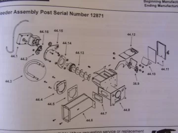

I would say no to the MFG debris. The airwash is connected to the combustion blower so if you are not getting a burn issue I would not worry about that. There is a flapper in the feeder assembly that "might" not be opening all the way you can check that by removing the left rear panel and check with a flash light. Is there outside air hooked tot he unit???
Eric
part 44.4 is the flapper

Yeah, no burn issues at all. Could it be a blockage though between the combustion blower and the 20+ holes at the glass? Or if it was, would I notice a bad burn because of this? Yes, it is connected to an OAK. Would this flapper then be on the opposite side of the feeder assembly from where the fines compartment lid is? I will have to check this out then tonight once I get home.
Perfect thanks!
Yes I know exactly where that flapper is then. I can actually hear it open and close sometimes when I open and close the glass lid on the hopper. I can hear it make a little noise from moving from the suction created in the hopper.
If you are hearing that I would say it is not blocked. Remember air that goes out of the stove needs to come into the stove. If your house is tightly wrapped it is not flowing like it should so that will cause a dirty burn. If your vent pipe has an extended run (EVL) the flow is being obstructed and this will cause a dirty burn. It can be the installation and not the stove. 95% of stove issues are a dirty stove or a improper installation.
