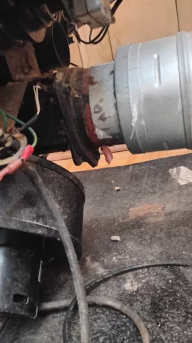

Wheres the best place to seperate this pipe? The reason I ask is I was told not to try to take the bolts out if the cast iron exhaust.
I see the orange seal looks damaged. Is it reusable and if not what can I use to replace it. I measured the temperature there and it's around 150f. Don't need carbon monoxide poisoning. Local hardware carries sealer good to 350f and aluminum tape good for the same temp.
That looks like red high heat RTV ie Permatex brand. I have a stove adapter on mine, and it came with a flat gasket, but that is between the stove and the adapter. You can pick some up at Ctire or any auto parts place ect.
I hit Homehardware, it has 450f sealer. I measured the temps, it's 150f there

This that 3-4 inch adapter double walled I'm concerned about exhaust fumes leaking. I other words does it slip over the outside and slip inside? I want to make sure it's sealable before I take it apart. I have a tube of sealer. Id have a professional do it but I'm looking at a long wait and it's getting noisy.
The adapter on your pipe will be single wall and will slide over the adapter on your stove. When you have it apart you should clean both surfaces with a wire wheel and remove all the old silicone. When you put it back together you can either run a bead of heat resistant silicone over the seam or tape it with foil tape.
Much thanks, I knew I should have got the tape instead, but I got the the silicone. 👍 It appears it was put on the inside that's why I asked and got a tube if silicon. And will that self tapping screw cut through the adapter or am I drilling a new hole? It appears to be steel.

It seems the tail pipe is cast iron, no self tapping screws
I think it's supposed to be friction fit with the RTV. Some may add a screw but you would need to drill it. On mine there is a special Harman adapter tail piece and it bolts onto the stove and then goes onto the double wall like a regular joint.
Reactions: Ssyko and Spaz
There's a self tapping screw in it now, but if I miss it putting it back on, then I'll have to drill it. I considered taking the 3 bolts out of the tail pipe/ flue adapter, but I've been told not although it would make life easier. 1 is loose, but of course there's the chance of busting them off.

Why do they not take the 3 bolts off the tail pipe, vs undoing the pipes and having to line them up putting them back on.

I've acquired a 3rd body to help. And 3 of the 3 bolts on the tail flue are loose 🥳 So I'm going to do it that way, no need to unseal, clean messy sealer off and mess around with the pipes themselves.

Keep in mind there is a gasket behind the tailpipe where it bolts together. If it is in good condition when you pull it apart it can probably be reused. If not it will need to be replaced.
