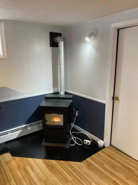

I starting thinking about moving mine. It's on a steel floor protector. When they were installing it, they had the venting already attached to the stove including the long slip vertical section. Two guys moved it into place then slid the slip section up onto the 90 near the ceiling. I'm guessing this is the way I should move the stove forward, just reverse the steps. I saw some little dolly's I might be able to put on each corner.
