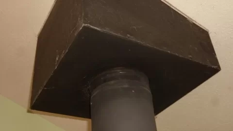

After installing my new stove I noticed my 1988 double wall pipe between the stove and ceiling needs a new coat of paint . I want to take care of that this summer but need to know how to disconnect the double wall pipe at the ceiling/ triple wall connection. I don't see any screws so it is not obvious to me.
Thanks in advance for any help here.
At my SIL's the tailpiece of the support box and the connector pipe screws are visible, so I lucked out there. Maybe you can go in the attic and see what's going on in the support box? I don't know as much as webby and other installers would about how that stuff is fastened. I like his suggestion though; Paint it in place with a couple of box fans blowing in the windows to exhaust the fumes out of an open window near where you are spraying.

Wow, I just saw the screws around the bottom side edge of the support box...didn't see those when I took the pic. I would guess the bottom plate would drop down. Good deal, since I was wanting to see if the support box was done properly. I wasn't sure I could get very close to it from the attic, since the roof slopes down and it's only a few feet from the eave...might be tight and I don't want to slither my way back there on my belly in fiberglass insulation. <>

I don't see any screws at the top connection, although there does appear to be pilot holes for them. Perhaps it is just pushed on?
I have no idea who manufactured the pipe. The labels that were on the pipe are no longer in place or legible.

My setup looks very similar to yours, just pilot holes and no screws (I have more dust also :cool:). I may try just carefully twisting connection to see if it comes loose.
