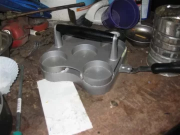

Last year I received my first Super Cedar samples and seeing as I was in school, not working and living off my wifes salary, I thought hey I can make these and save money. So I did and they worked out great! So if you are in a pinch as I was or are simply thrifty (nice way of saying cheap!) you can follow these steps and make your own.
I received my case of Super Cedars today and thought I would add to this post. I didn’t want to do so last year because I didn’t want to seem as though I was trying to take any business away from Super Cedars co. especially since they sent me a free sample. So I waited until this year and after I purchased my case of Super Cedars to write this post.
What you will need:
Parafin wax
Cedar wood chips/sawdust
Muffin pan/hamburger slider maker
Muffin wrappers
Free time.
First you need some cedar or other type of wood. I had some left over cedar fence boards that I took my chainsaw to and cut some kindling and the left over saw dust I put in a box for later. I also am into woodworking and so sawdust is never in short supply in my house so I mixed a bit of that in as well.
Next melt down some 100% paraffin wax tea candles from the Dollar store in a coffee can inside a pot of boiling water(double boiler style). Once the wax is melted simply add a cup or so of saw dust to the can of melted wax and mix with a stick I keep adding sawdust until the saw dust is permeated with wax but not too wet.
Now put your wax paper cups into the muffin pan and scoop some wax/sawdust concoction into the paper cups about 2tsp full and press down with a can or whatever you can find that is close to the same circumference of the muffin pan. This will compress the sawdust and bind it together let it dry. If it seems too or if there is wax sticking to your ‘press’ then you don’t have enough wood fiber add more next time. You are now done.
Just light the paper wrapper and that should ignite the sawdust puck and you are on your way to starting your fire. I really works great and really isn’t much of a task.
