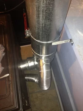

I have seen worse, yours is not bad. If you have an OAK (Outside Air Kit) and live in a damp area. (By a lake, ocean or there is morning dew) Then the OAK will bring that damp air into the burn pot and exacerbate the ash build up. Only a system that warms and dries out the burn air like Selkirk DT venting can vastly improve that.

.....the OAK will bring that damp air into the burn pot and exacerbate the ash build up. Only a system that warms and dries out the burn air like Selkirk DT venting can vastly improve that.
We've had this discussion before. There is no proof or data that confirms this. There is no guarantee that using the DT venting will help this, unless you've found new "proof".
It helped tremendously in my situation, and I hear it is more of an issue in the North East from one of my National Sales managers.

Selkirk DT does warm the fresh air coming into the burn pot. So there is no cold air mass meeting the warm moist air mass in the stove to produce rain! That is an exaggeration but no moisture precipitates out causing the ash to stick together like the ash turds in the Harman burn pots. These turds are on each side because that is where the cooler OAK air meets the warm moist air around the fire! With Selkirk DT there is no cold air to cause the moisture to precipitate out causing the ash to not stick together!
In the case of my Astoria being in a basement, the caked ash at the bottom of the burnpot is where the cooler moist air from the OAK met the warm moist air under the burn pot so moisture precipitated out causing the caked ash! After the Selkirk DT install, no more caked ash!
Some people around here seem to have the opinion that Selkirk DT is better for your stove than other venting... It is not. It doesn't dry out air coming in and it doesn't do anything to improve combustion than installing a regular OAK would do. Yes, cut one very much bigger hole... That's the feature and benefit, all in one.

You are correct Scott it does not dry the fresh air, but it warms the fresh air coming in so you do not have a cold air mass from outside coming in contact with warm air inside, creating rain. Well rain is an exaggeration but some moisture precipitating out causing the ash to stick together more. I must say it only happens when running the stove on low heat settings and on damp early mornings. So many people are not effected and may not see that problem. Also, I have seen that problem more on stoves with a manual damper rod and more on stoves installed in a basement where the air can be more damp.

What you are explaining about warm air and cold air makes no sense. Warm air and cold air don't make rain. In extreme conditions it may make wind. Rain from air masses is totally different and has to do with saturation and depressurization. Dude, were talking about air going through a tube at a pretty good clip to it's final destination in the burn pot. Let's just say for example that the air coming in was 50::F and the exhaust going out was 300::F...and let's say that the air coming in was actually able to heat up...what? 5::F? 20::F? ...that would also mean that the exhaust was able to cool even more...Sounds like a creosote problem in the vent...wouldn't ya say?
