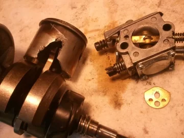

I just lost a PP260. It gets ugly in there when engine ingests the choke plate screw. Amazing but cylinder looks great. Is it worth $18 piston kit and scrounging a proper choke rod? I dunno - I sell them for $70.
