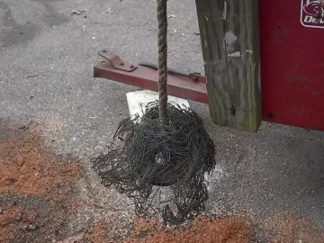

Or a ball of chicken wire and a rope.

Actually I can't take the credit even though I have used some pretty weird things to clean a chimney. The chicken wire idea is from seeing what hearth.com's favorite building inspector has been using for 28 years to clean his chimney.

right, 2 ropes..... um..
wife on the bottom right?
