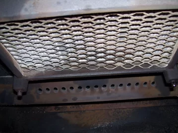

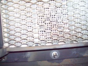

Thanks for the tip. I was going to do what you suggested, but there is a heavy screen below the cat, that I cannot remove. Looks like the cat is pretty clogged up.[Hearth.com] Do I need to replace my cat? [Hearth.com] Do I need to replace my cat?

I don't see cat cloggage. You can also use a shop vac tube to suck on the face of the cat.
Is the screen welded in there? I can't tell from the pictures if it is OEM or someone just stuck it up in there after they bought the stove. Also, the cat doesn't really look that bad from the pictures.
I bought the stove new and had it installed. The screen is free moving, but it is a heavy material that I cannot bend, and fits in there on bottom shelves, so it won't just drop out.
I think I will just go ahead and spray the cat and use a shop vac to suck up all the junk.

Looks to be in decent condition. How many seasons are on it?
Don't get too aggressive with the shop vac. The cat ceramic is brittle material.

Just one season, and I did not burn any overnight fires...I plan to leave it in and blow compressed air and then vacuum. with the screen in there is not way the shop vac can even touch the cat itself...
That sounds almost new. Keep the compressed air pressure low. You are just blowing out fly ash.
